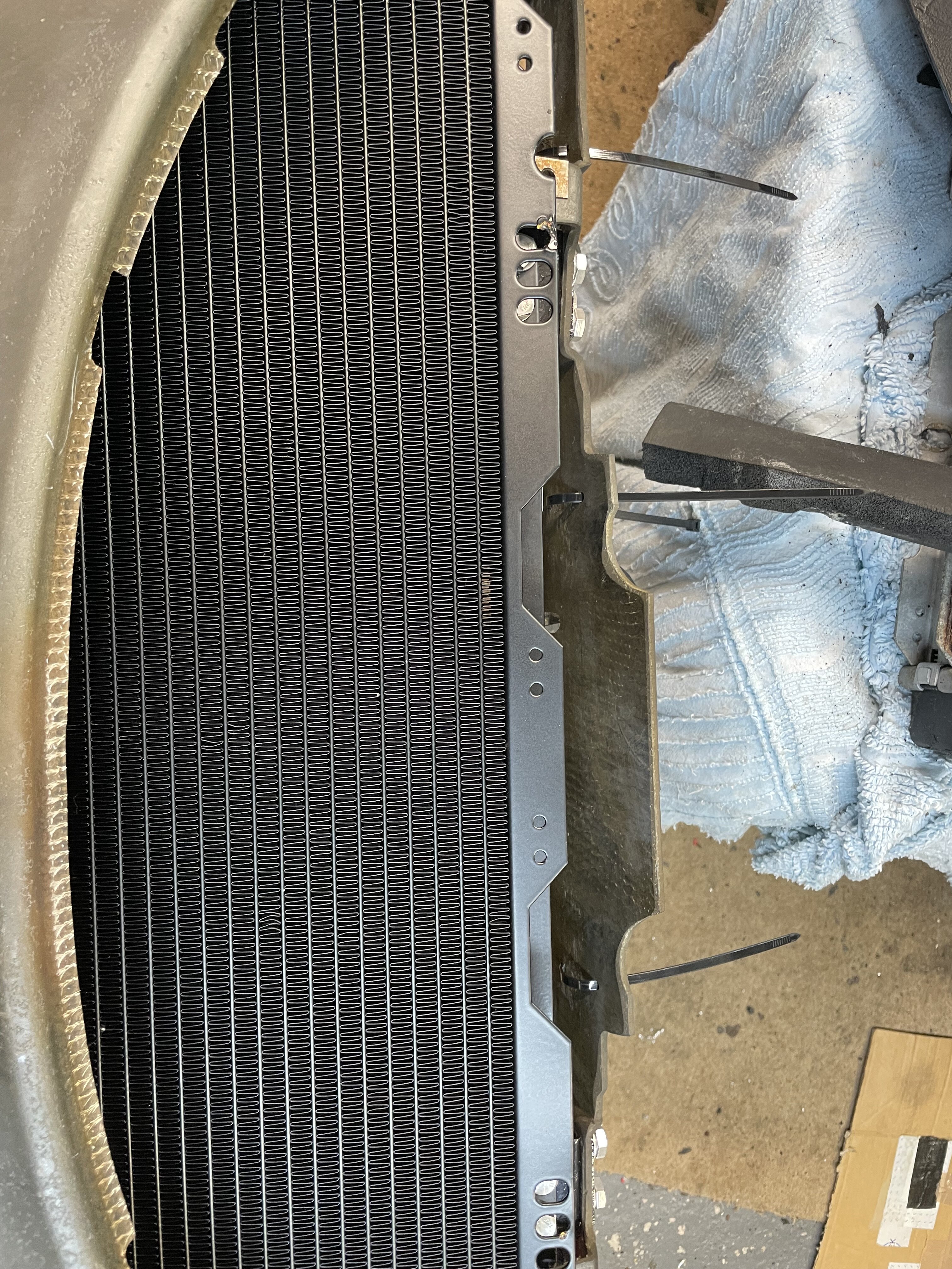

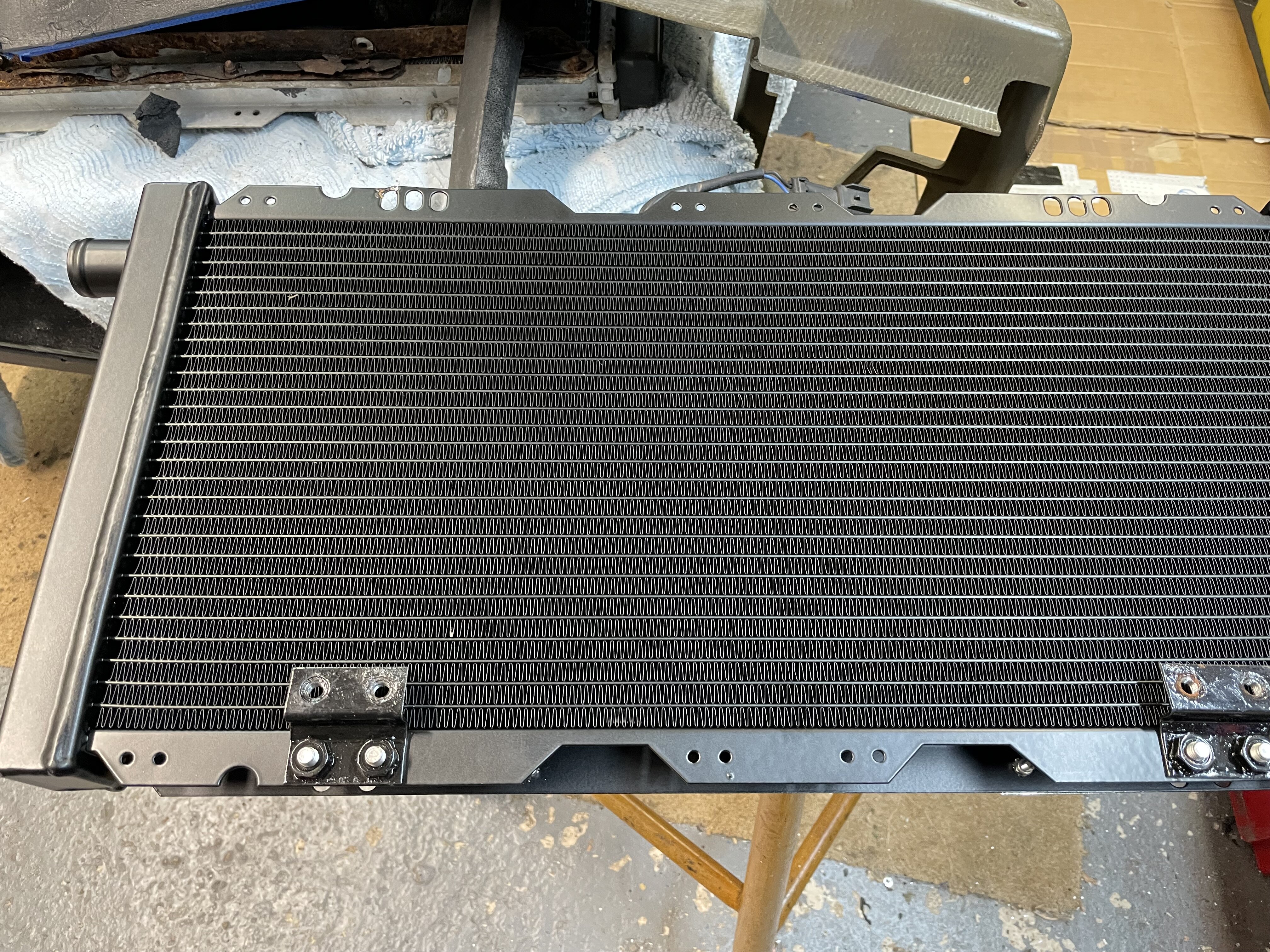

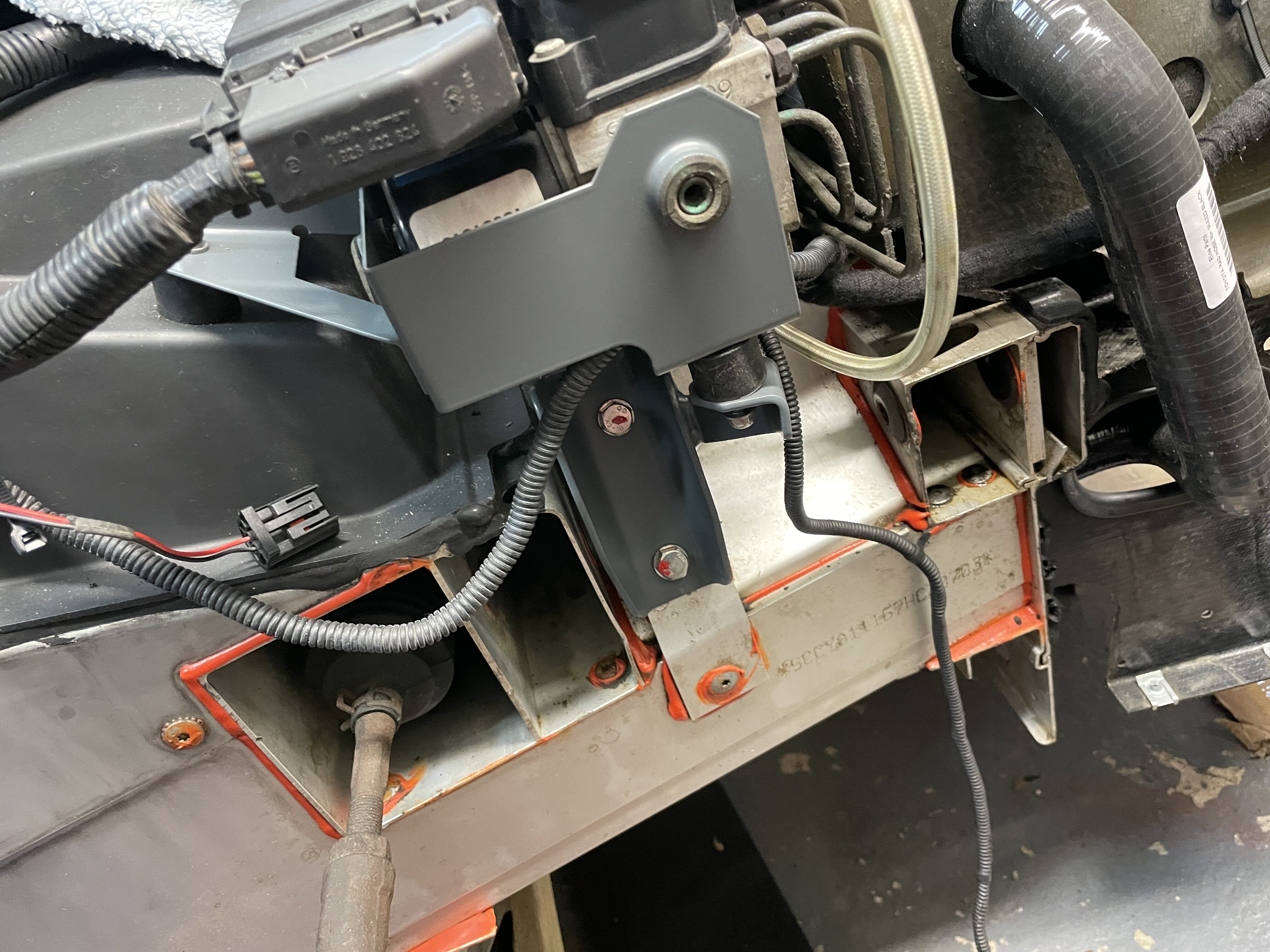

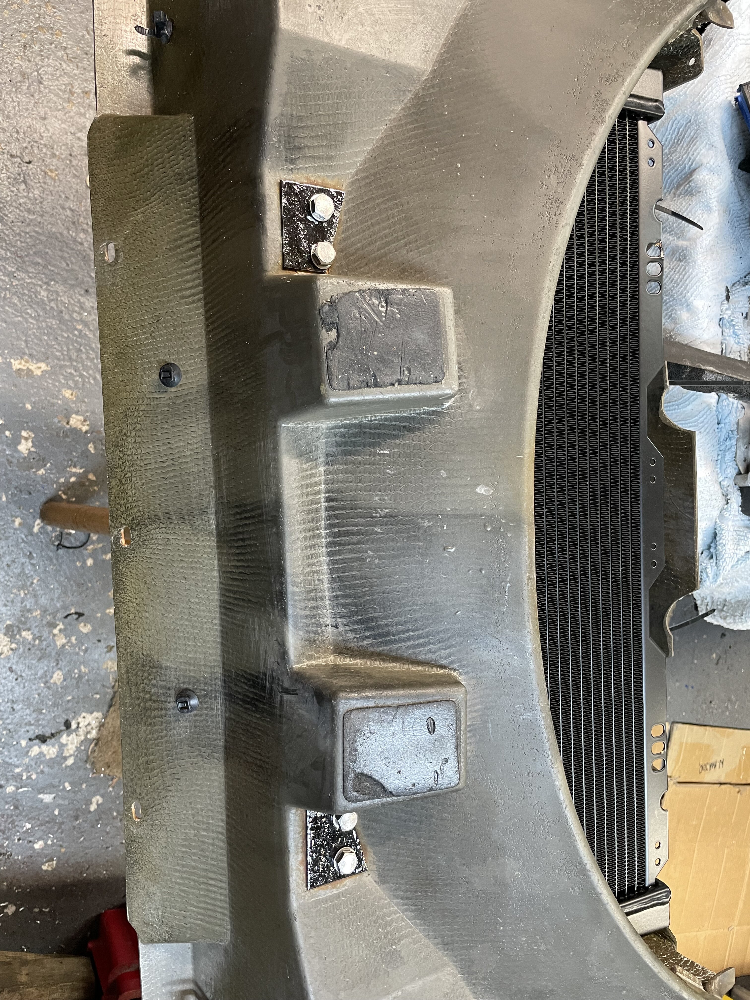

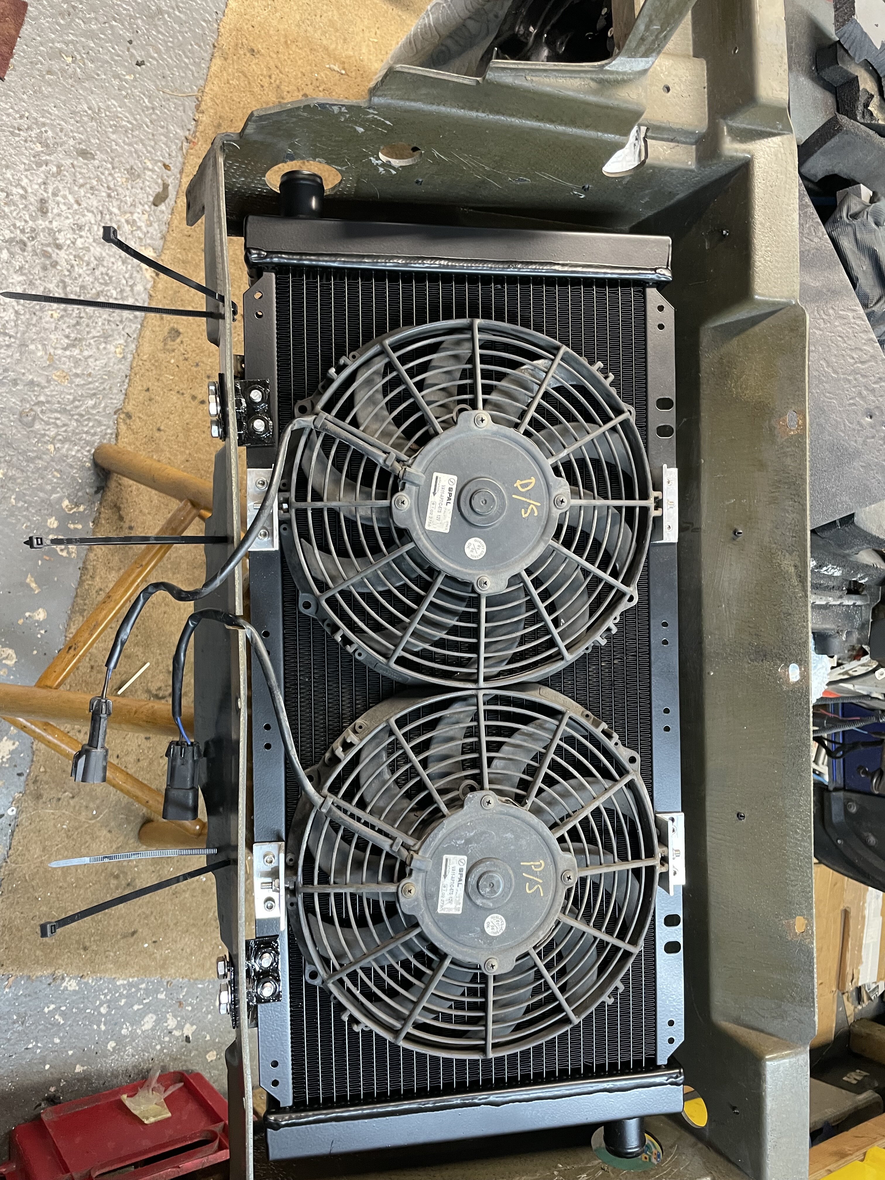

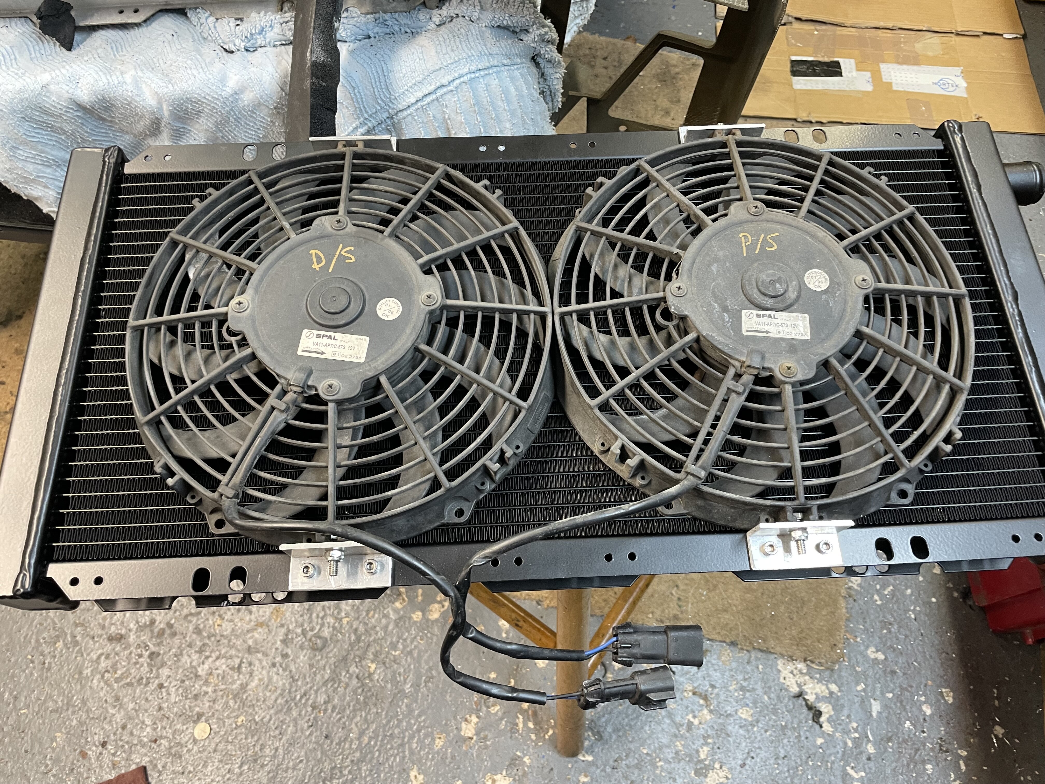

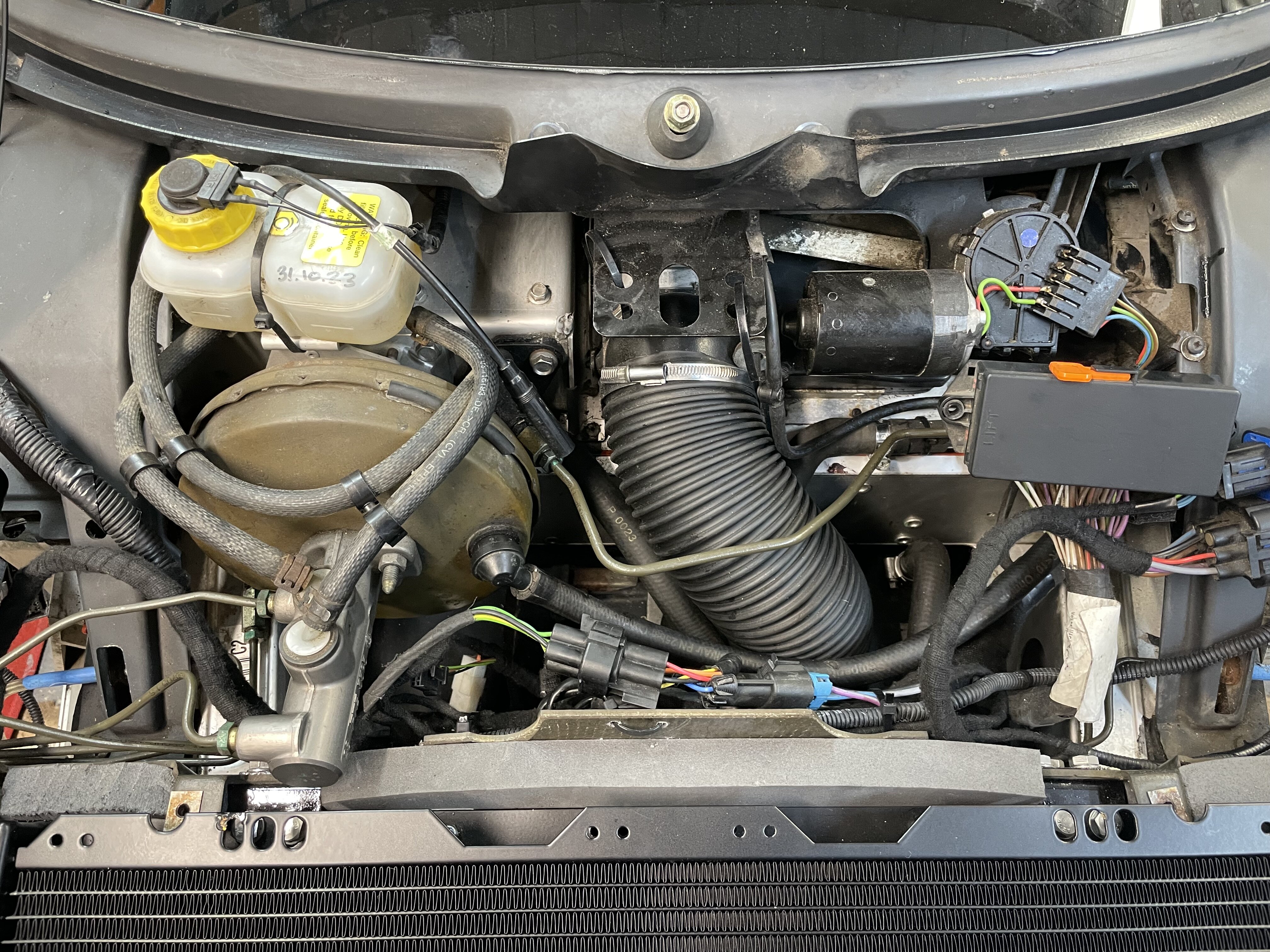

Andy wright Posted January 12 Author Posted January 12 More radiator work this afternoon. Brackets to mount fans to rad made. Freshly painted rad to housing brackets fitted with new bolts and washers, albeit loosely for the moment . Next job is to make up some fresh foam packing to fit between the radiator and its housing, as the original stuff is a bit , err crusty. Anyway, that is for another day . Quote

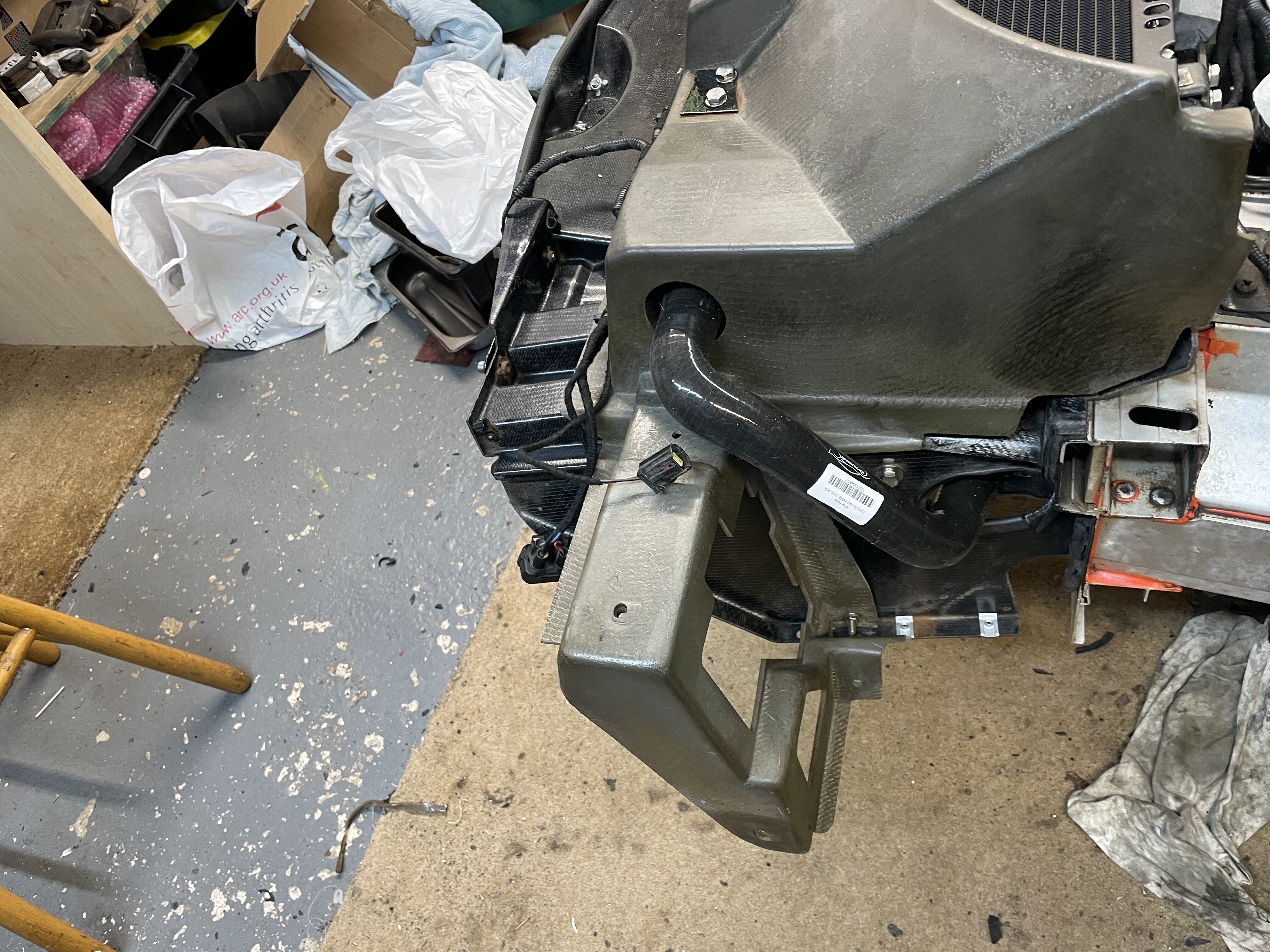

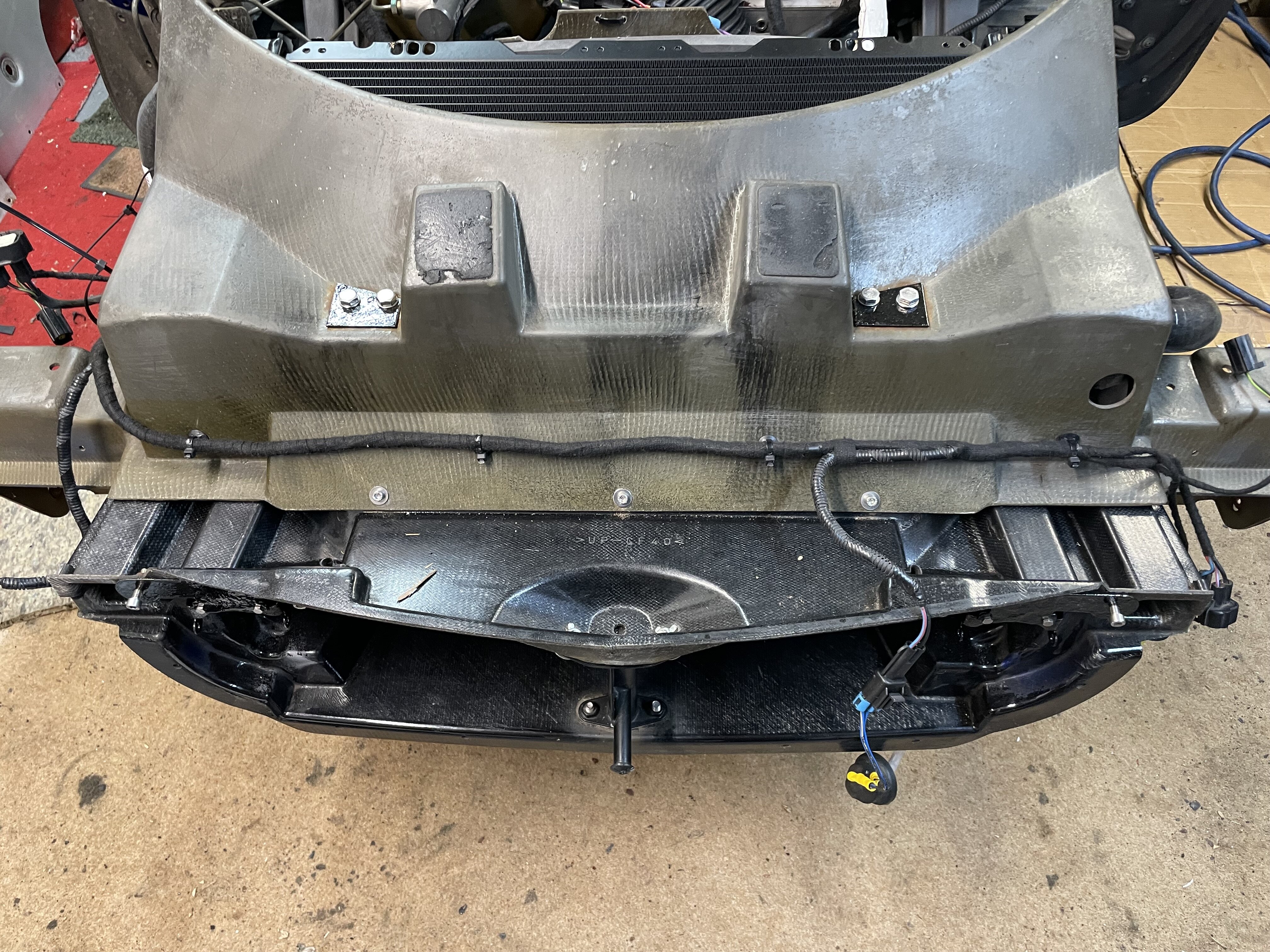

Andy wright Posted January 13 Author Posted January 13 Finished fitting the radiator to its support and then replacing the foam with some new bits . All now re fitted to the crash box and the wiring loom more or less back in place. Next job is to paint and rebuild the callipers Quote

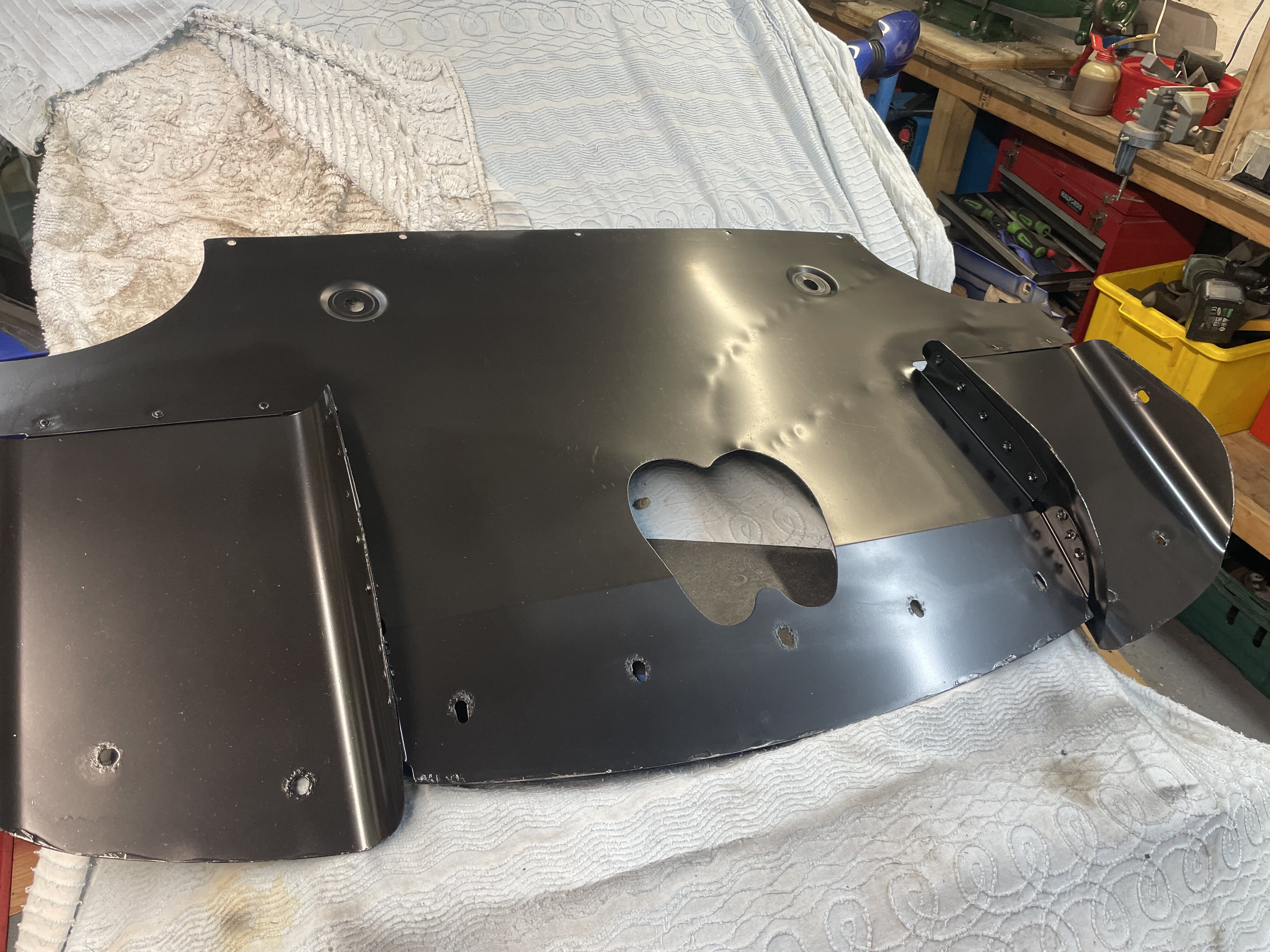

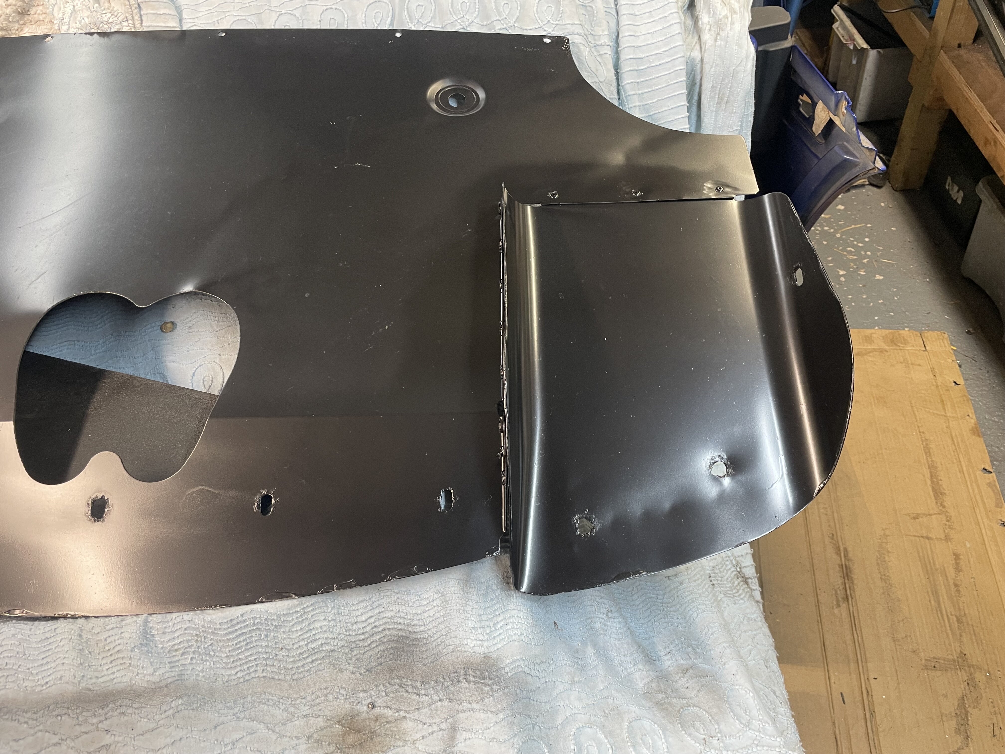

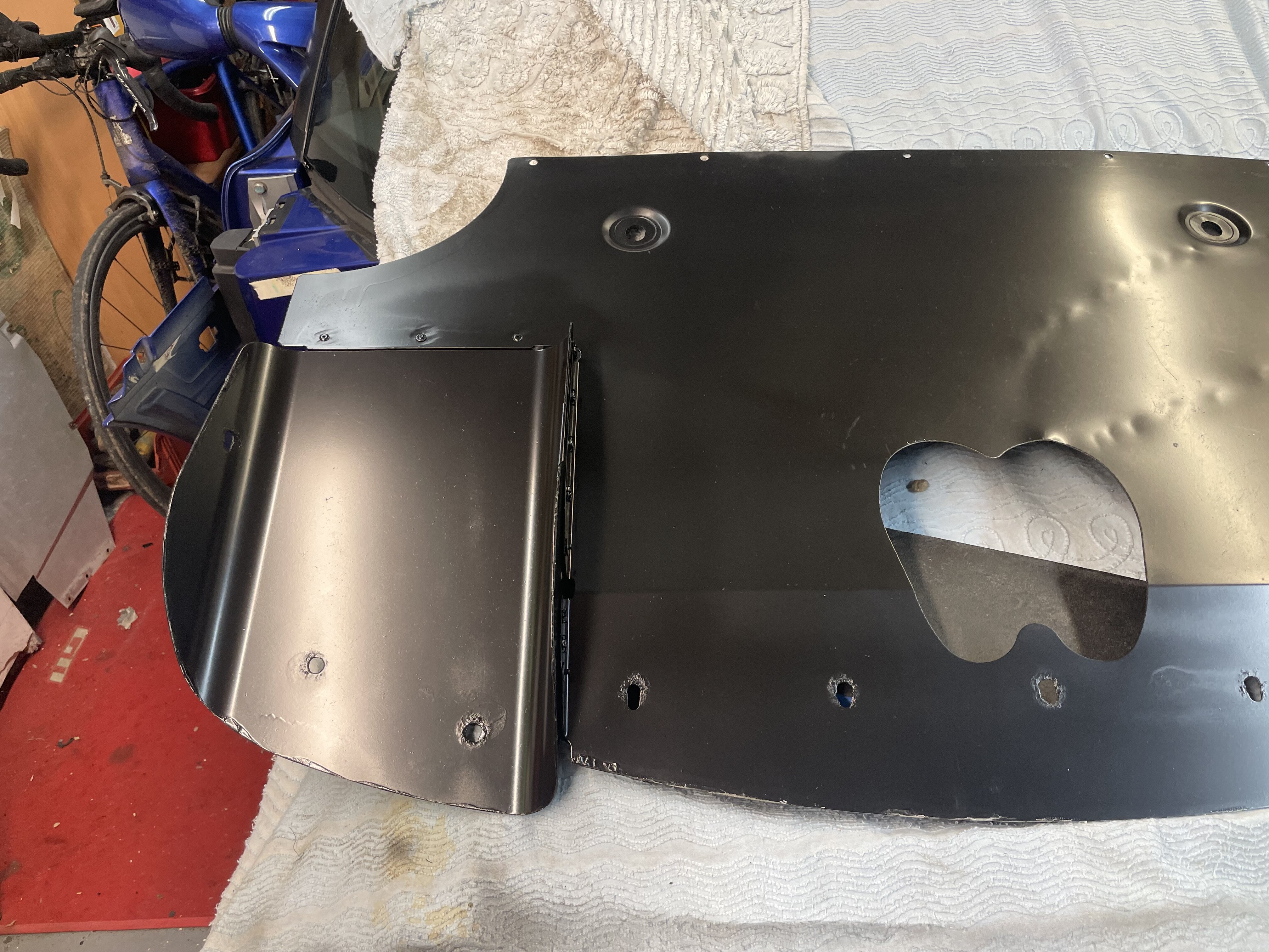

Andy wright Posted January 16 Author Posted January 16 Diffuser now fixed back together and in a coat of black paint. Just the clear lacquer to add and some edge trim and another job gets ticked off the list . Quote

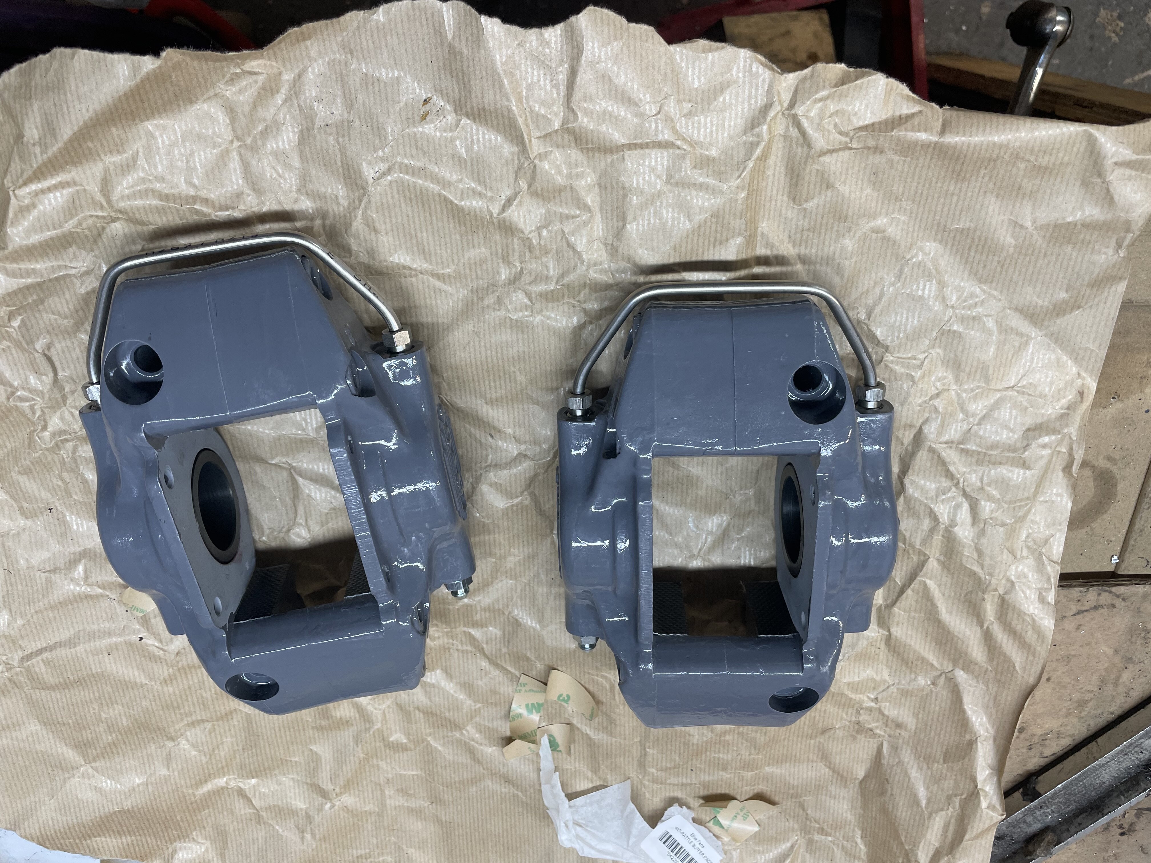

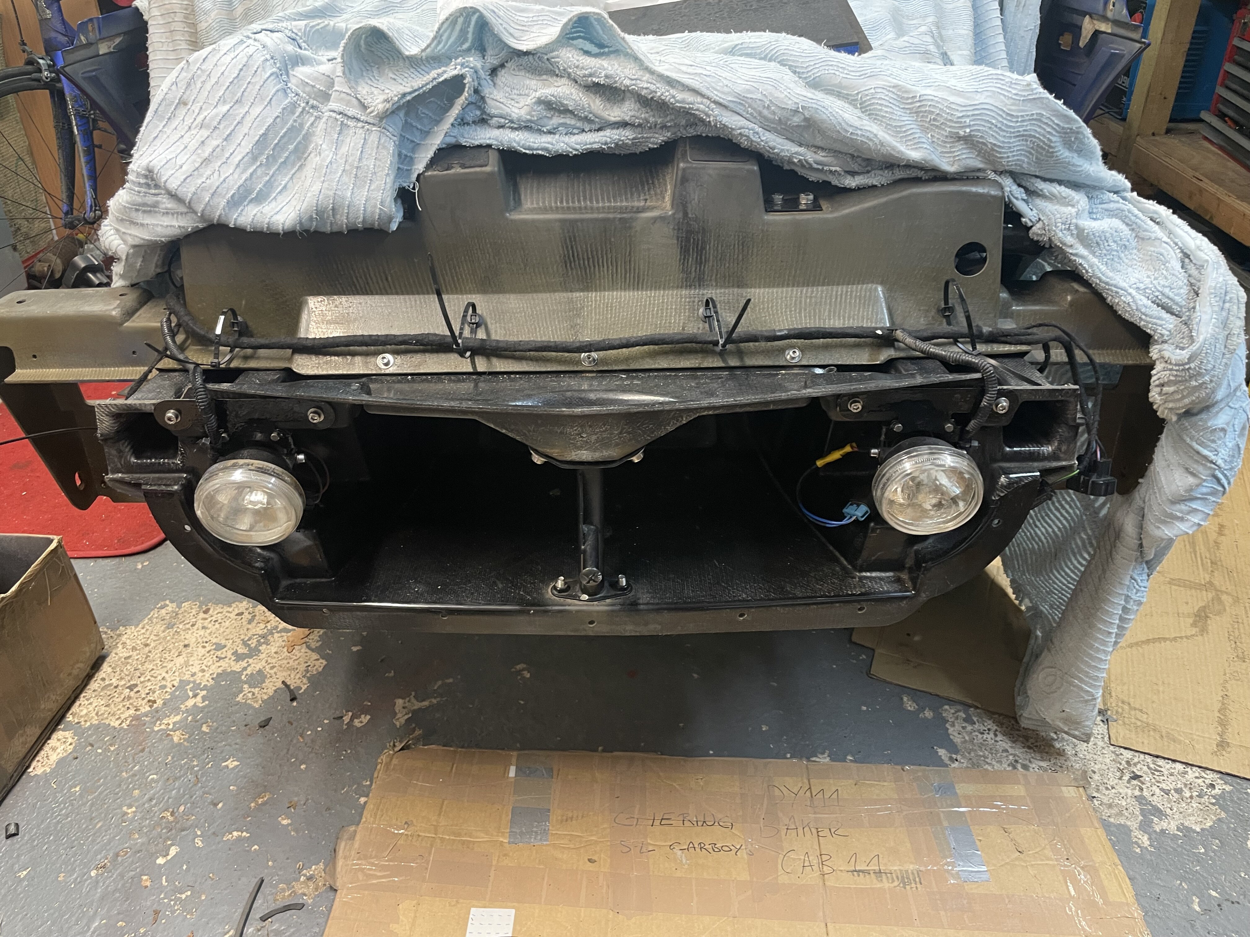

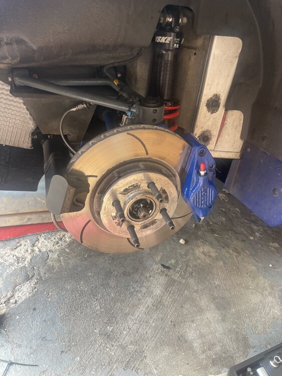

Andy wright Posted January 19 Author Posted January 19 And a bit more progress, with front brake caliper rebuild ( thanks Eliseparts, their service kit is brilliant ) and the front fog/ spot / whatever they are lights cleaned, painted , rewired and fitted back in place with some new screws. As an aside, I have made a new friend in the Elise community , Dave Robson, who not only lives just ten minutes away from me but has recently bought and repaired a crash damaged S2 Rover Elise and, to put it bluntly.with 50 odd years of building and racing cars, definitely knows which end of a screwdriver to hold( read knows an awful lot and is very keen to share it . I have numerous photographs and some very , very slick suspension spreadsheet calculations to illustrate the point ) 1 Quote

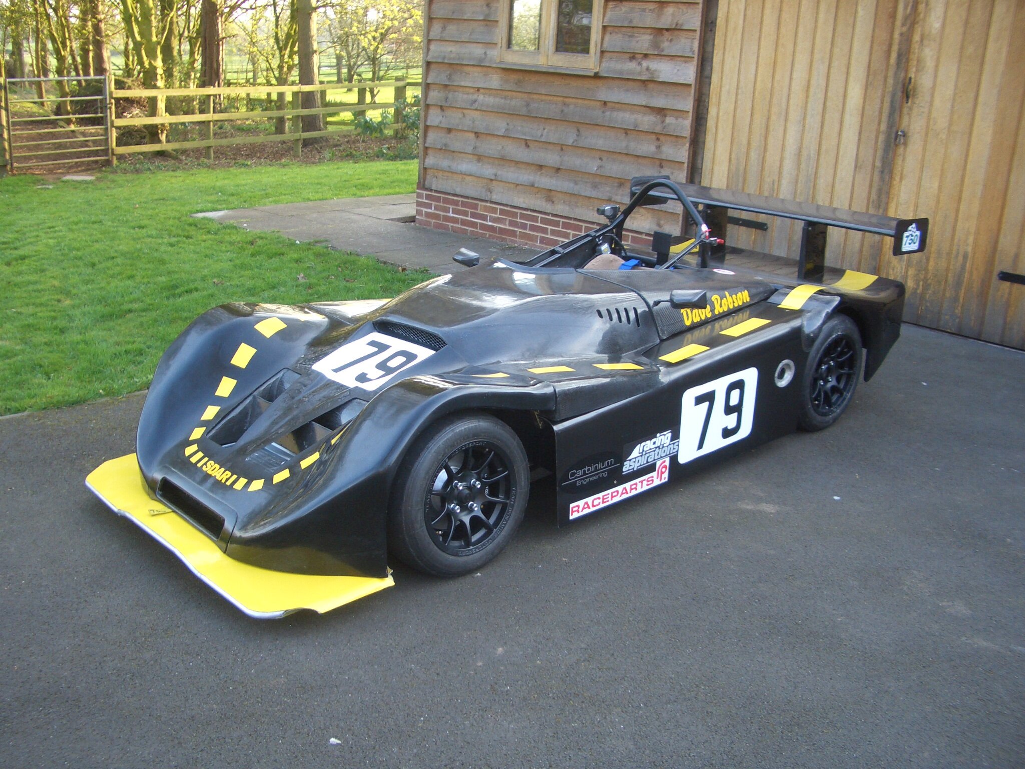

Popular Post Dave R Posted January 22 Popular Post Posted January 22 (edited) Andy Do you mean that turny thing with a flat blade at the end?? Seriously............good to find a like-minded builder so close to me. Here are before & after shots of the Elise 111s plus one of the race car I built and recently sold (750 Formula) Dave Edited January 22 by Dave R 4 Quote

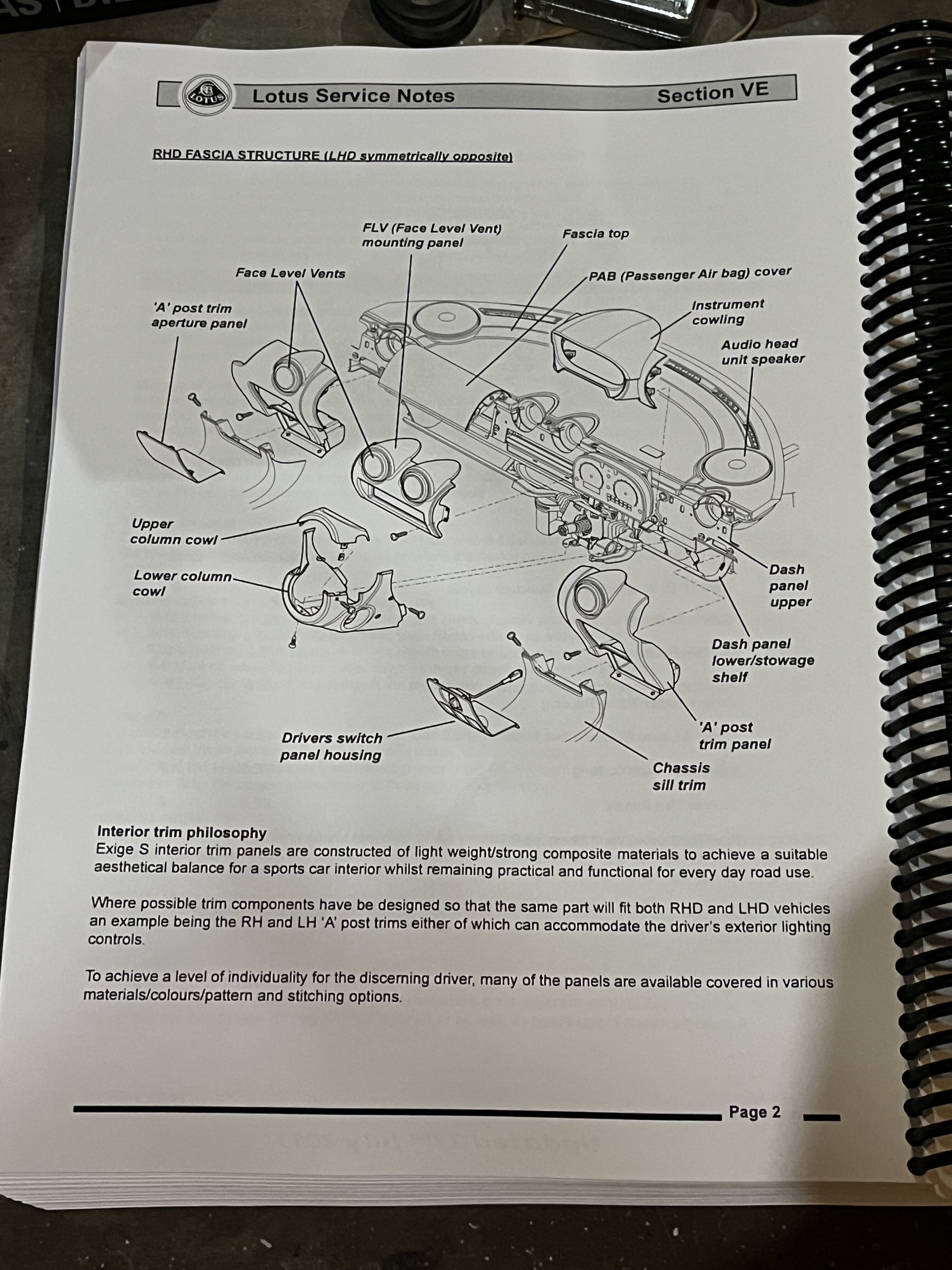

Guido Posted January 22 Posted January 22 Someone from SELOC very kindly sent me the workshop manual (.pdf) for an Exige. I’ve had it printed and bound at an online printers and I’m ready to go when something needs fixing. For me, it’s nice to have step by step instructions and schematics when taking something apart. Quote
Badger02 Posted January 22 Posted January 22 50 minutes ago, Guido said: Someone from SELOC very kindly sent me the workshop manual (.pdf) for an Exige. I’ve had it printed and bound at an online printers and I’m ready to go when something needs fixing. For me, it’s nice to have step by step instructions and schematics when taking something apart. Guy, I thought you didn't know one end of a spanner from another ? Quote
Guido Posted January 22 Posted January 22 (edited) 13 hours ago, Badger02 said: Guy, I thought you didn't know one end of a spanner from another ? Quite the opposite. I’ll try most ‘simple’ things but I hate doing stuff blind. Step by step instructions are always a good confidence builder. YouTube is always helpful but a proper manual is perfect. The challenge with the Exige is getting access to stuff. I want to check my washer pump but access is from under the car so the front under tray has to come off!! Edited January 23 by Guido Quote

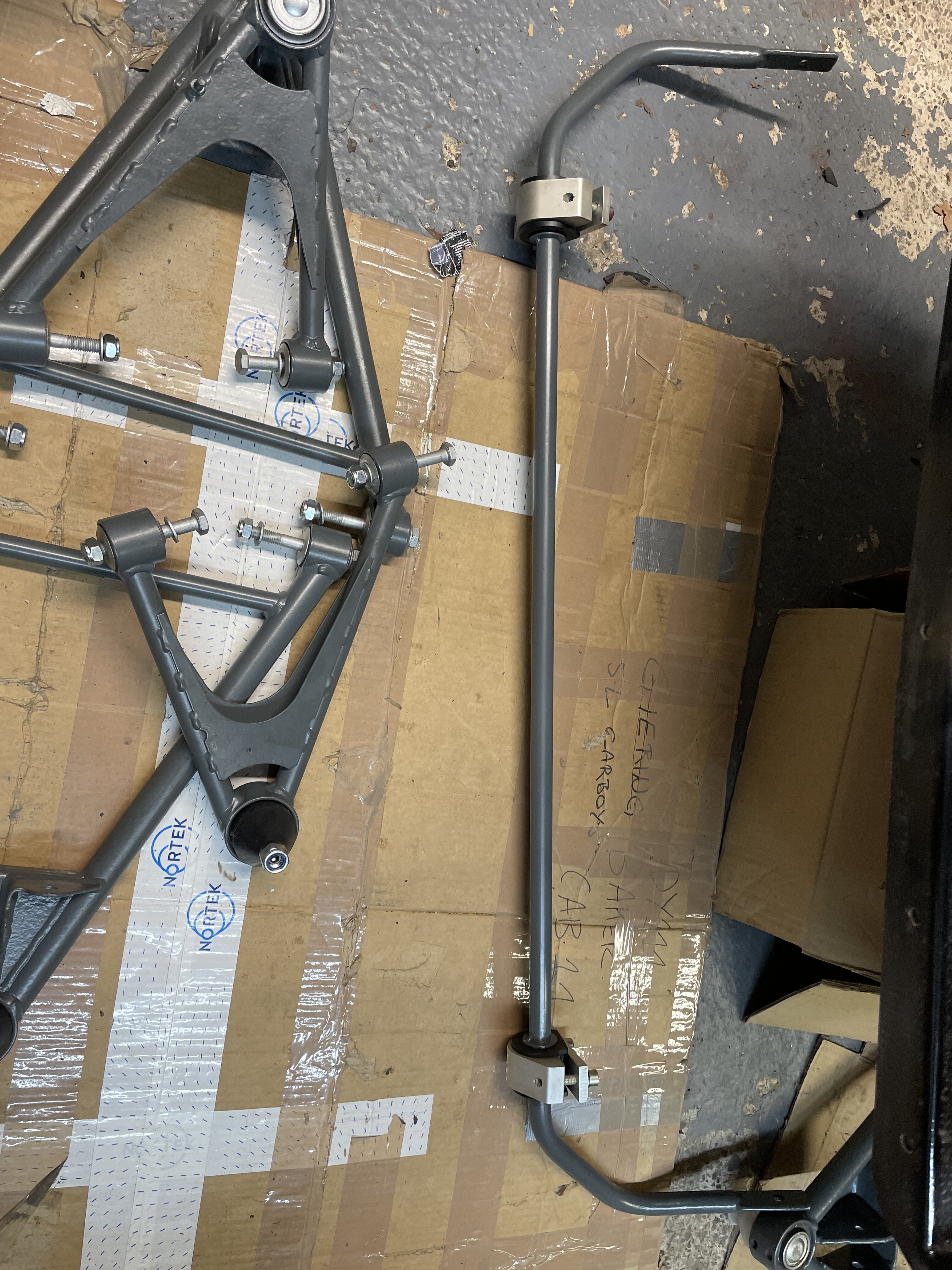

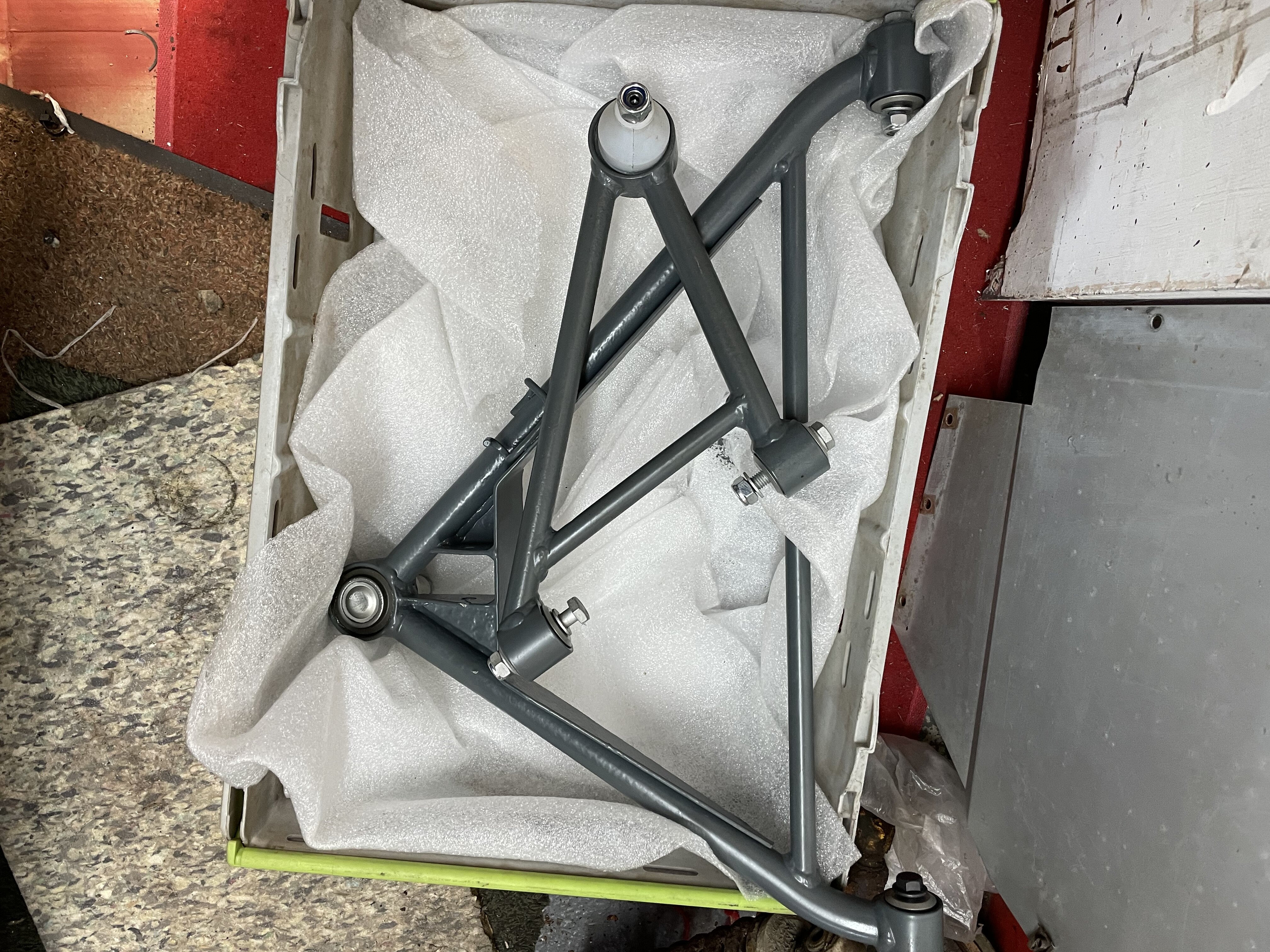

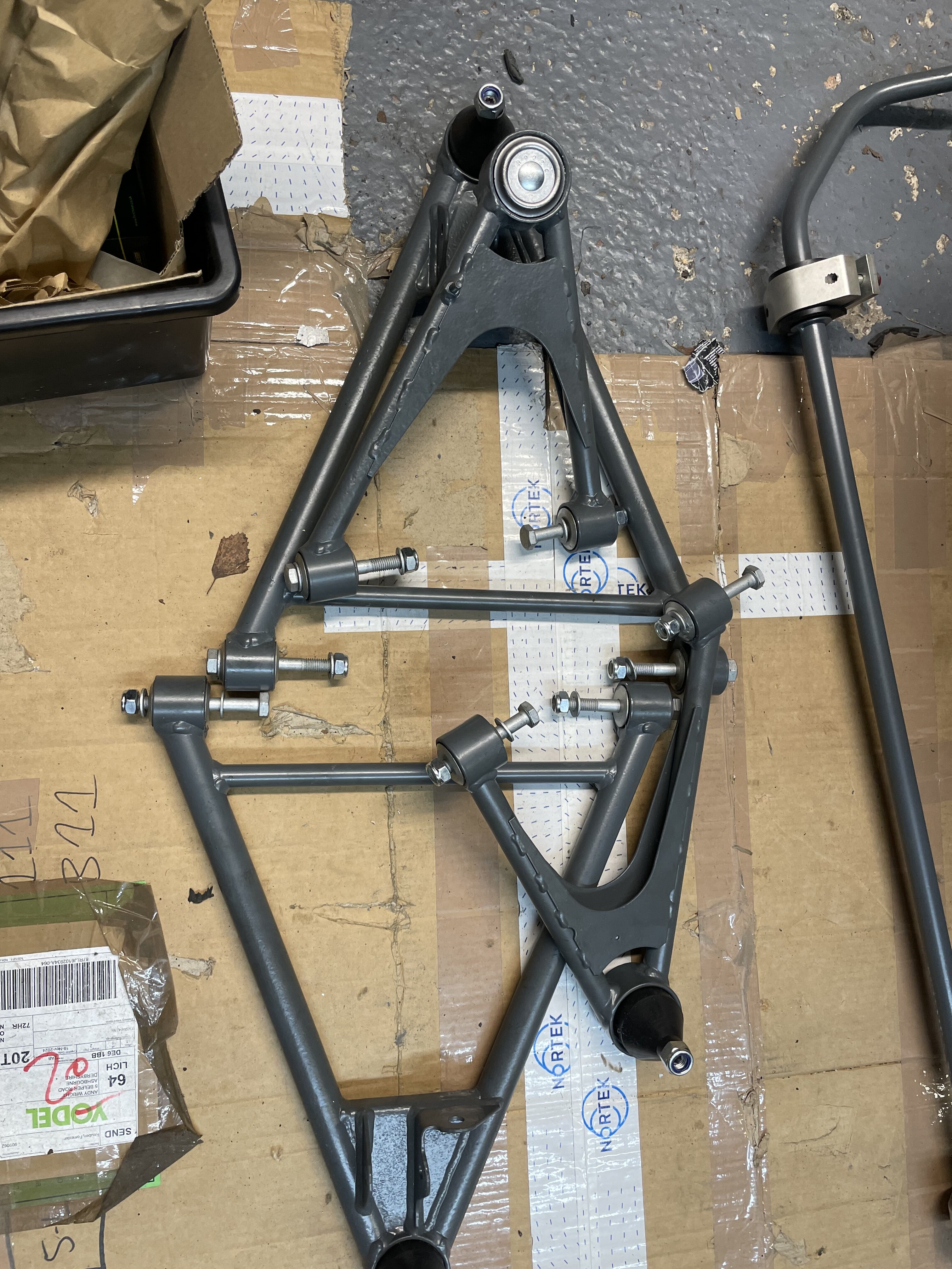

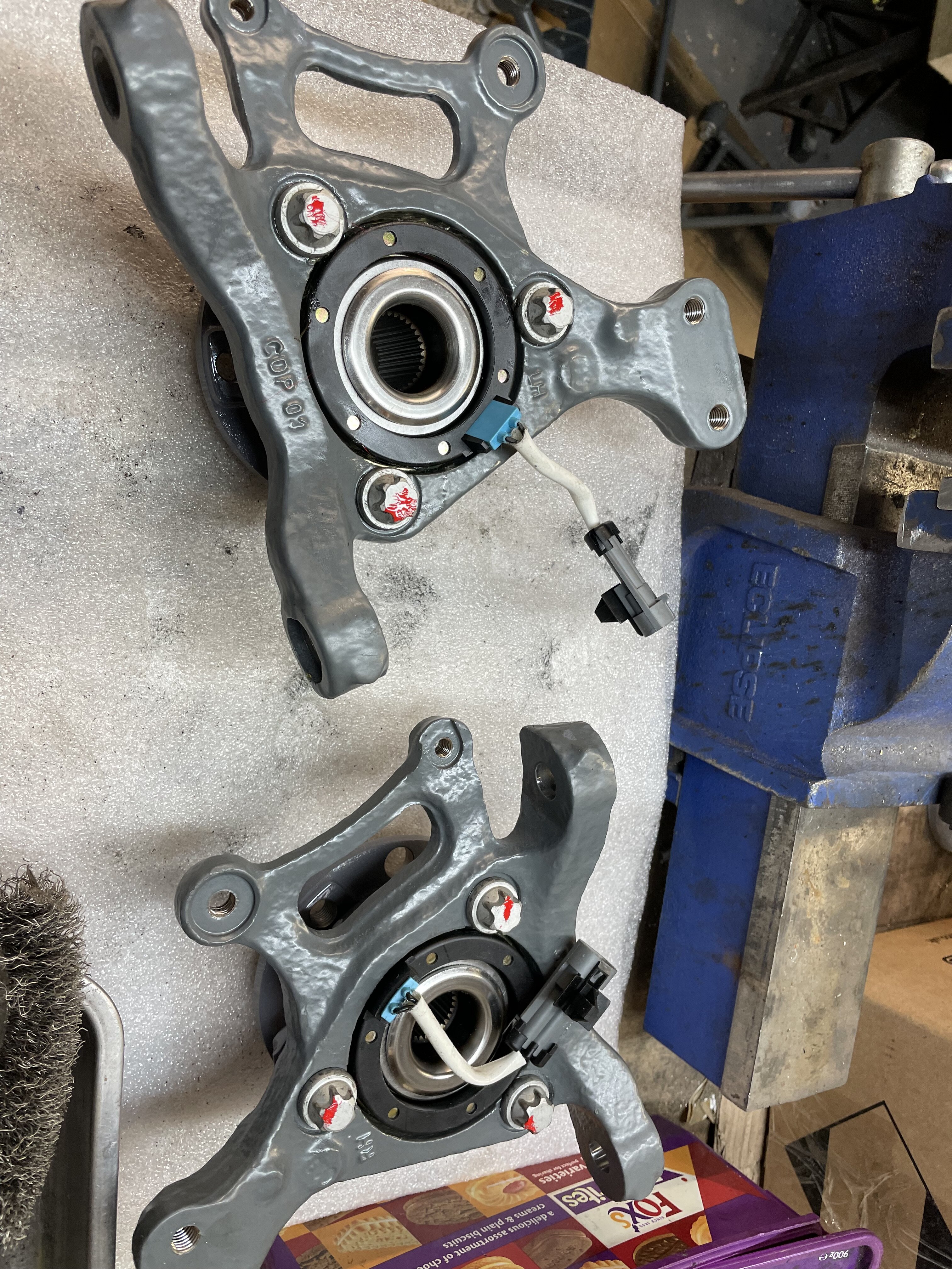

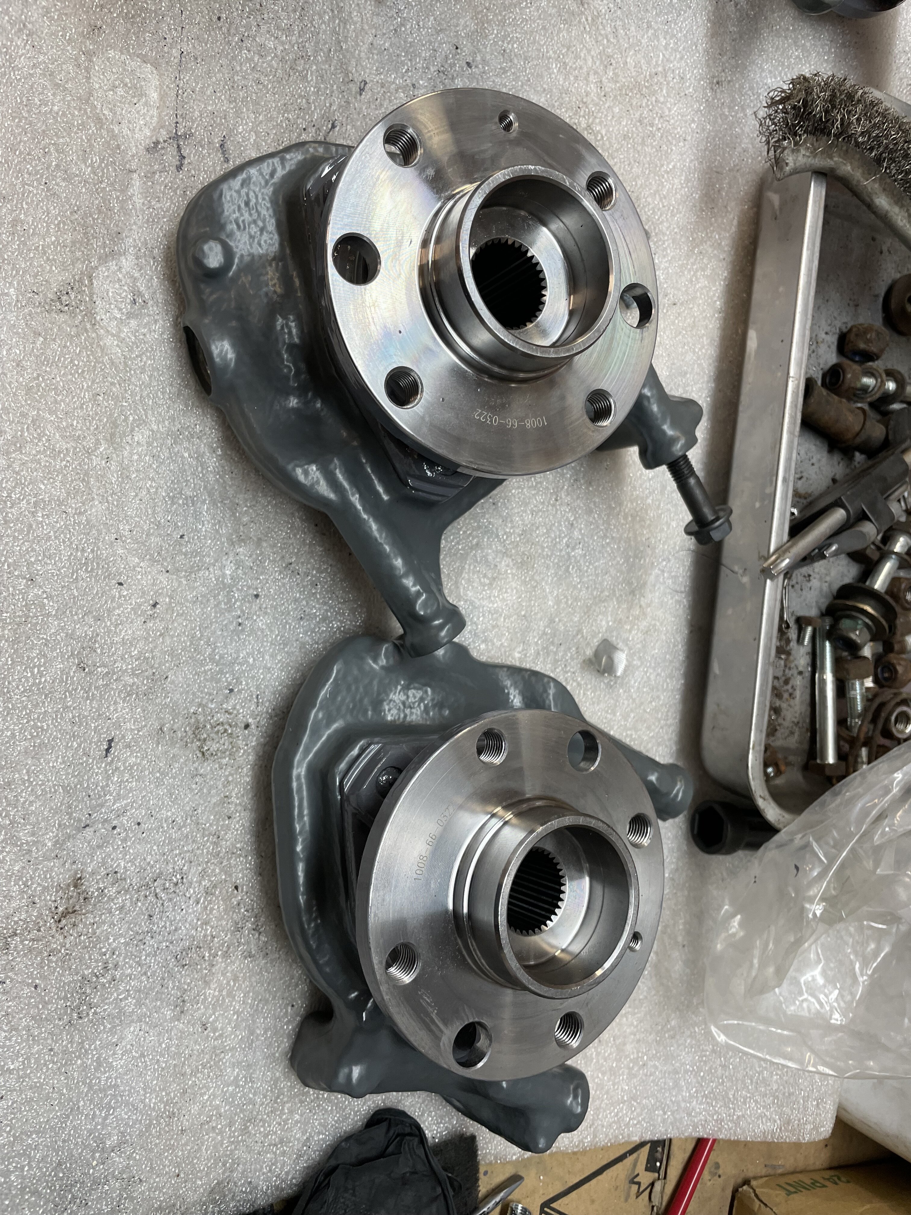

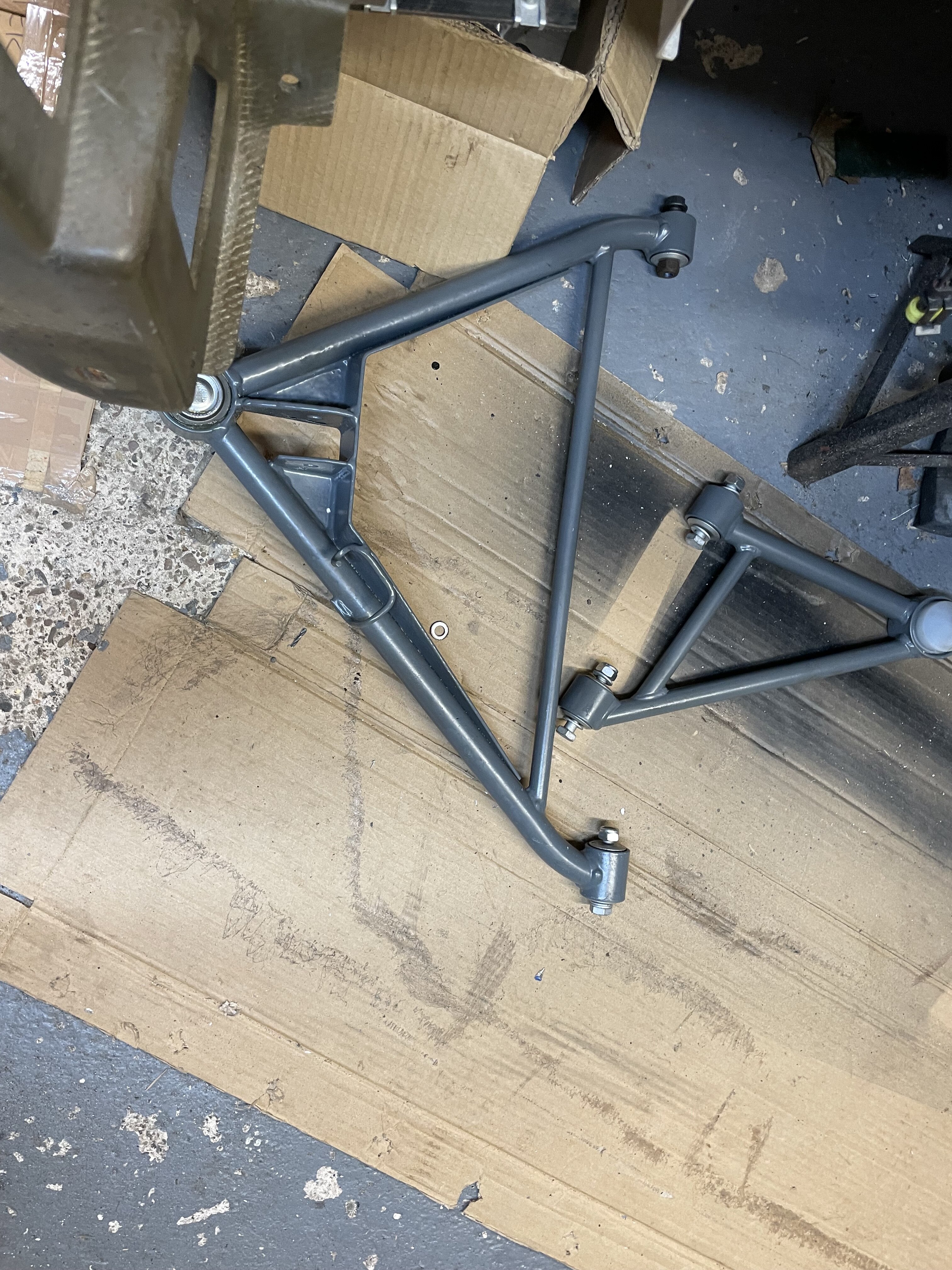

Popular Post Andy wright Posted January 23 Author Popular Post Posted January 23 And in other news, suspension bits back from the powder coaters . Blasted, primed and coated . New ball joints installed. Ditto new bushes ( read spherical bearings ) . New wheel bearings bolted into the hubs. ( and yes it did take an age to clean out all the threaded tappings and the bush/ bearing housings . The coaters had been fairly careful but I did agree to do any residual cleaning up . ) . Progress now on hold whilst I replace the inter cooler on our ‘ everyday car’ which is outside in the rain in bits because the garage is , err, otherwise occupied . 3 Quote
